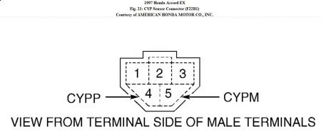

Originally Posted by csk.jfoxx
im running internal coil
How did you make the change from a four-pin (external coil) distributor connector to a five-pin (internal coil) distributor connector?

Changed it the harness and ecu but I'll check again. I did all the engine and tranny with and my friend did the harness and ecu but I'll check. You know what color three cylinder senor is?

Sry damn auto spell but you know what color the cylinder position sensor wire is

There are two:
  1. CYPP: YEL (or ORG) to dist. connector pin 4, YEL from connector to ECU pin C4
  2. CYPM: BLK (or WHT) to dist. connector pin 5, BLK from connector to ECU pin C14
In the Common DIY Sticky there's a link for online manuals. Find and download the '96 (or '97) wiring diagrams.

Hey wasssup, checked the wires and everything is correct. so what do i do now? thanks for everything everyone
